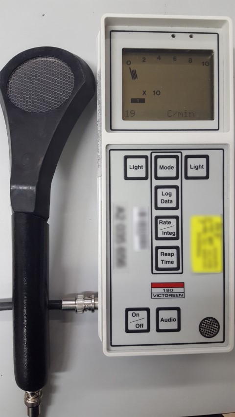

The Victoreen 190 with pancake probe:

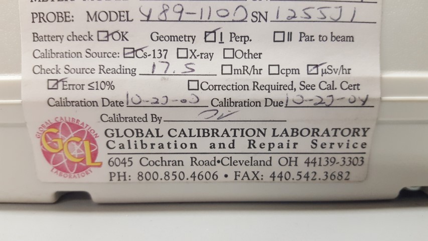

Check source details:

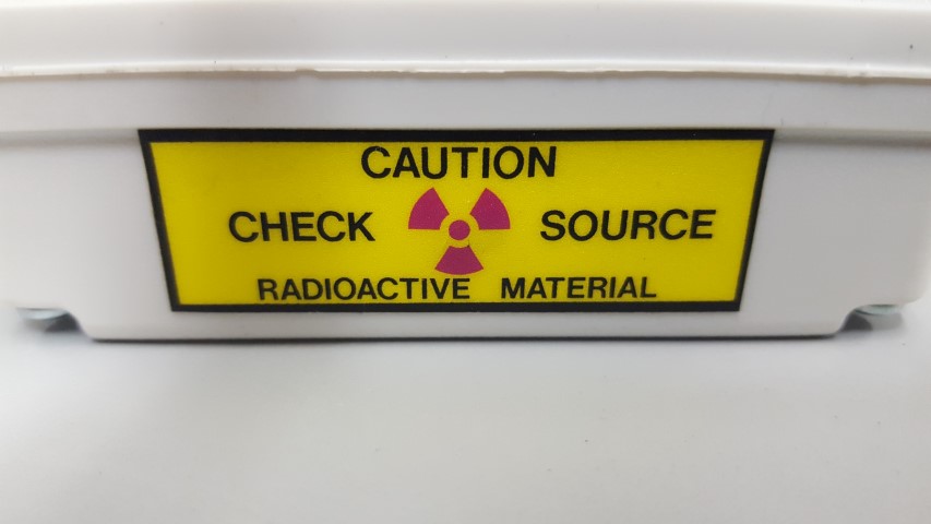

Check source location (on top of the survey meter):

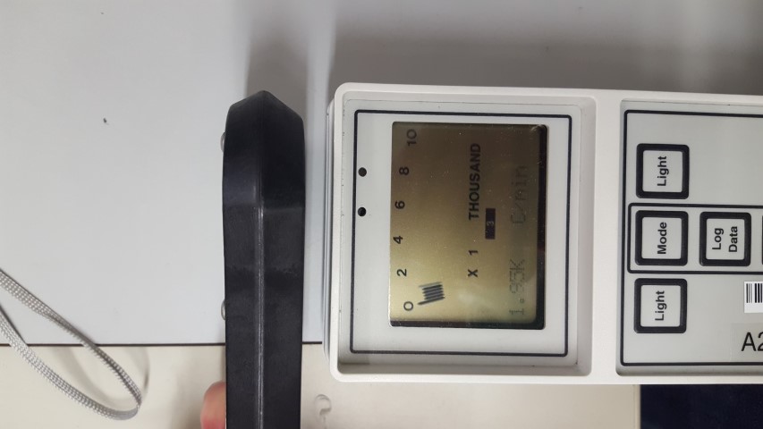

Measurement with the Victoreen (set to CPM):

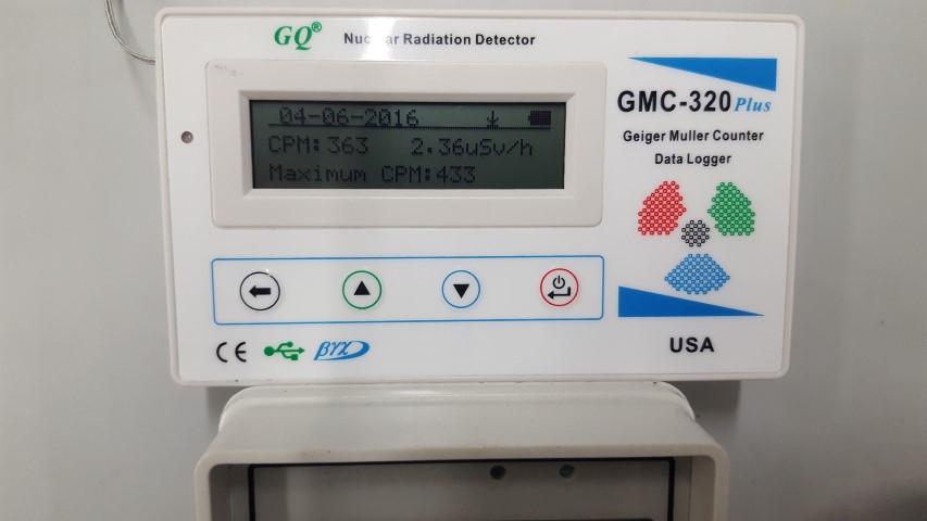

Measurement with the GMC-320 Plus:
88316 bytes
I only measured for a couple of minutes, but you can clearly see the Victoreen registers roughly 4 times the amount of counts than the 320 Plus. Since the check source is a Cs-137 source which emits beta radiation of 0.5 and 1.1 MeV + gamma radiation of 0.6 MeV (emitted by the decay of Ba-137) and all these radiation types & energies are well within the detection range of the M4011 GM tube, I imagine the difference is mostly caused by the fact the pancake probe has a larger surface and is more sensitive than the M4011 tube of the 320 Plus. And of course, the Victoreen is about 15 times more expensive. It only needs a few seconds to stabilize at ~1500 CPM.

Not exactly.
Try the same again but this time open the case of the 320. The plastic is so thick it blocks much of low power beta radiation.

Posted - 04/07/2016 :  10:22:04  Show Profile  Reply with Quote
Good point. The plastic does block most of the GM tube. Will try.
