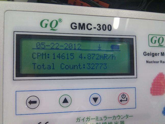

Hi,
I just received my GMC-300 yesterday. Bought via ebay.
At first, it looks like working normally, reading 0.12uSV/hr or something like that.
But, after a few hours, it reads like this... 14,615CPM and 4.872 mR/h right on my desk. It does get same huge reading after factory reset.
What's wrong with this unit?
Should I send it back for repair? (I'm living in South Korea tho).
Regards,
Nate Park
81.36#160;KB
Edited by - Nate Park on 05/21/2012 21:45:30
Posted - 05/22/2012 :  11:36:05  Show Profile  Reply with Quote
It seems the tube needs a longer aging time.
All new Geiger Counter tubes need a aging process before to let it reading stable. The aging time may be different between tube and tube.
Switch it off for a few minutes and then turn it on again. Let it work for a few days continually.
If the problem does not go away after a few weeks. Then you need to send it back for adjustment/exchange.
Nate Park
Posted - 05/28/2012 :  22:21:33  Show Profile  Reply with Quote
After 3 days of continual using, the problem persists.
It reads about 15,000 CPM now..
Would you please let me know where should I send this unit for adjustment/exchange to?
Posted - 06/01/2012 :  22:09:17  Show Profile  Reply with Quote
Please write to support@gqelectronicsllc.com ask for RMA
