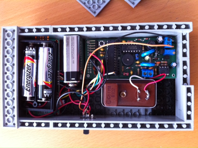

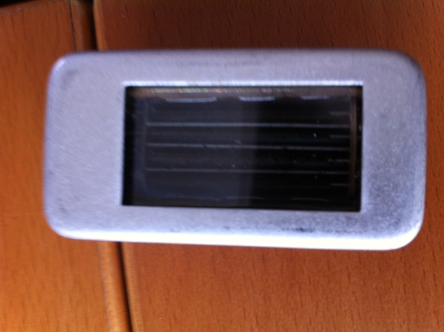

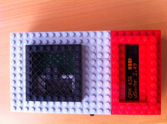

How is this for a geiger case? I'm using Soviet SBT-11A square pancake alpha geiger tube too!
152.15 KB
118.12 KB
87.71 KB
Posted - 04/17/2012 :  20:48:38  Show Profile  Reply with Quote
Cool! Lego Geiger Counter.

I have a GMC-280, I had to un-solder the GM tube clips and re-solder them. I also had to solder a jumper wire to the new clip location to make the SBT-9 work. That was all and it was easy to do.
I have never seen a GMC-300, so I am not sure.
