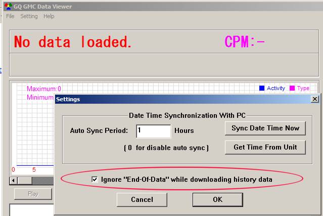

Posted - 02/03/2014 :  22:11:05  Show Profile  Reply with Quote
The download history feature only supported on Data Viewer software. Not PRO.
Do not try to change the comport baud rate. The Data Viewer software fixed the baud rate to 115200 for GMC-320.
check followings:
1. make sure your GMC-320 used 115200 default baud rate.
2. make sure your Windows device manager detected the GMC-320 comport. See: http://www.gqelectronicsllc.com/forum/topic.asp?TOPIC_ID=3796
3. before you downloading, make sure you connected to the GMC-320 correctly. When software detected GMC-320, it should display a short message in the message box: GMC-320 Re.3.14 etc. You also can use GQ Term Windows to talk tieh GMC-320.
You said it download the 4% and then stopped. That means your GMC-320 on has 4% of data in the flash memory. Reset of 96% are blank.
If you want to download 100% with all unused space data, then from the Data Viwer softare menu, select Setting -> Other and then check the check box on Ignor the End of Data .
Download entire flash memory regardless of data or not:
