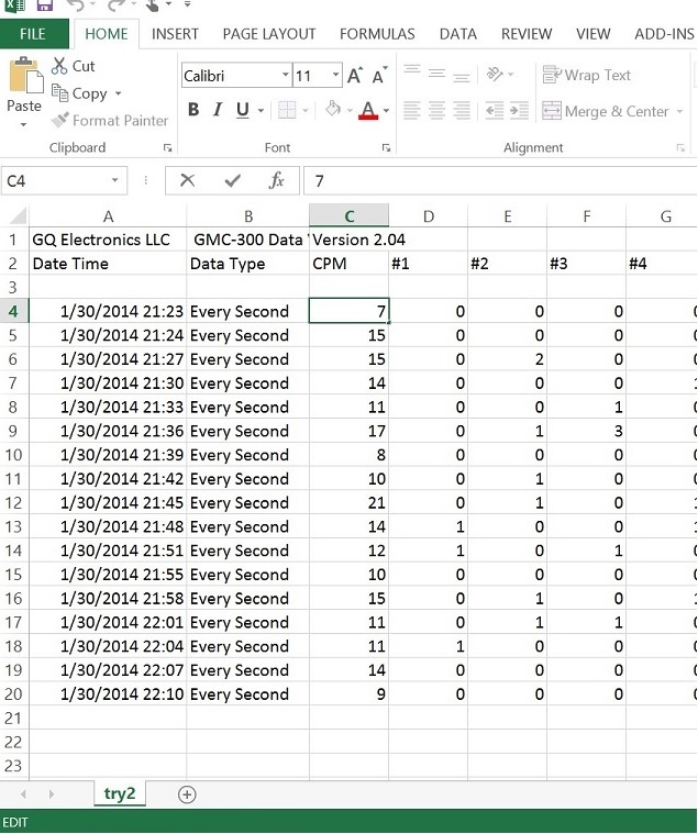

Any ideas?
Saved as all files instead of binary (binary saving seems to cause infinite loop) then save to .cls where dataviewer locks up and does not respond to windows. Generates .cls file, that when opened with excel only seems to log data for 20 rows.(not sure what the binary files look like). Appears to save data every 3.3 min or so.
Windows 8 64
GMC-320 v 3.14
Dataviewer 2.04
Thank you

Posted - 01/31/2014 :  22:39:17  Show Profile  Reply with Quote
Try to use Re2.07 Data Viewer software.
And see if it makes difference.

Posted - 02/01/2014 :  20:56:18  Show Profile  Reply with Quote
Works great as far as I can tell. (3/4 day data) Thank you! :)
