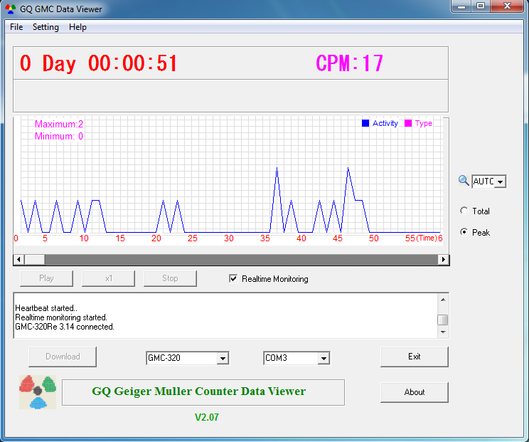

Posted - 01/10/2014 :  13:23:11  Show Profile  Reply with Quote
In the freeware version of the Data Logger software I can see the CPM and the radiation level, however in my registred version of Data LoggerPro the data is missing, everything else seem to be working smooth. Any ideas?

Posted - 01/10/2014 :  21:56:31  Show Profile  Reply with Quote
Looks like the software can not get registry information from Windows. Check your antivirus or Windows security setting. OR restart the Windows in safe mode and just try to run this software to see if it works.

Windows 7 x86, no antivirus installed
What I find odd is that the regular Data Viewer is ok.
