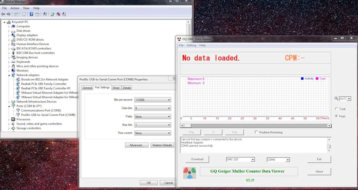

Hi,
I got the TOOL-081 Audio to USB data cable for Geiger Counter and cannot make it work with GMC-320 Plus. I'm using the default port speed of 115200. Any thoughts? My idea was to use one GMC-320 + device for two different applications using one USB port and one for Audio to USB port on two different CommPorts... So far cannot make the Audio-USB work at all in any GK software...
Thanks,
SUB750T
SUB750T
18 Posts
Posted - 04/16/2015 :  14:24:18  Show Profile  Reply with Quote
Tried with the headphone and I can hear low click in the headphones when speaker is ON, however still no data is going into the Comm port and the GMC Data Viewer. DO I do something wrong? the audio to USB port seems to be registered ok in Windows?
