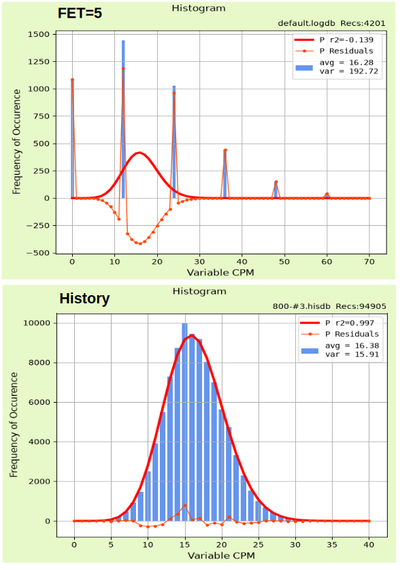

And the much dreaded FET "feature" has been runied even further. The picture shows the outcome for a Poisson test for FET=5 in the top pic. This is supposed to look like the bottom pic, which is the History read out from the very same GMC-800Re2.00. The data are there; they are just ruined by GQ's infamous algorithm !
Draw your own conclusions.

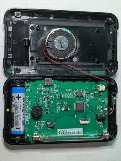

There’s a model name as well as what appears to be a manufacturing date printed on the motherboard (above the printed battery icon), if anyone’s interested, my unit is a “GMC8A_v1.03” with firmware version “Re2.00”.
