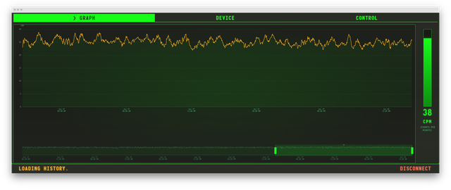

Hi! I discovered that, from a recent Chrome or Chromium browser, you can control your GQ GMC-800 dosimeter, sending commands and retrieving data, without installing any drivers or programs on your computer.
This is very much alpha/raw, but I'd love it if someone could test it with their device.
I only have GMC-800 with stock firmware so that's what I could test with.
Link: https://anatoly-scherbakov.github.io/webgmc/
It runs in your browser and does not upload the data anywhere. Screenshot:
Thanks!
