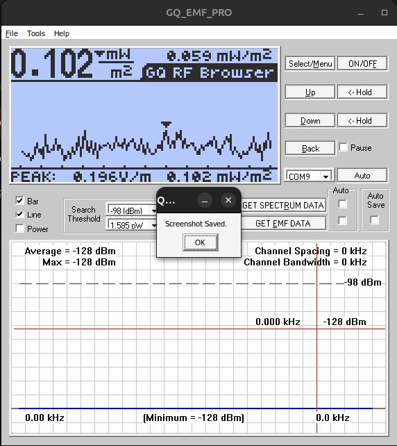

Hello all,
when I got the "GQ EMF PRO" app running on Ubuntu 24.04 using Wine and COM port mapping it failed to download History and Screenshots from the device. It turned out that the problem cause was not the „Winchiphead CH341" driver built into the Linux kernel (see https://docs.kernel.org/usb/usb-serial.html) but the baud rate that the app was not able to set to 115200 baud in the Wine environment.
Here is how I got everything working. ;-)
Best regards,
Manfred from Germany

Install the "GQ EMF PRO" application
wine GQEMFPro3.67.exe
Launching the "GQ EMF PRO" 32-bit Windows application
Launch the application by clicking the "GQ EMF PRO" icon.
If there is no icon for the application use the "wine explorer" command to open the Wine file manager.
The GQ_EMF_PRO.exe application can be found in the "C:\Program Files (x86)\GQ EMF PRO" folder.
You might have to reboot your PC before launching the application for the first time.
Don't forget to run the config-ttyUSB0-115200baud.py script after a reboot or after you disconnected the GQ EMF-390 device.
