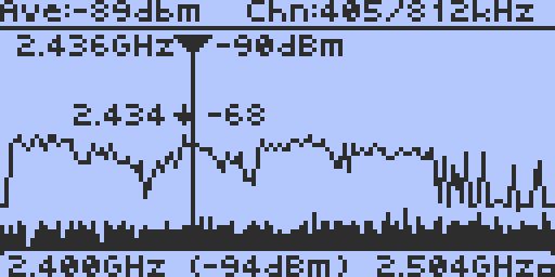

Good day, please let me ask what exactly the values on the following screen represent. I understand the concept of decibel and power densities. I would like to know what timeframe and frequency ranges the numbers are based on.
1. top left Ave:-89dbm
2. top center 2.436GHz -90dbm
3. center of screen 2.434 -68
4. bottom center (-94dbm)

1. average through the whole 2.4G spectrum
2. rf reading where the cursor is pointing to and frequency
3. peak rf reading past 3? seconds
4. min rf reading
