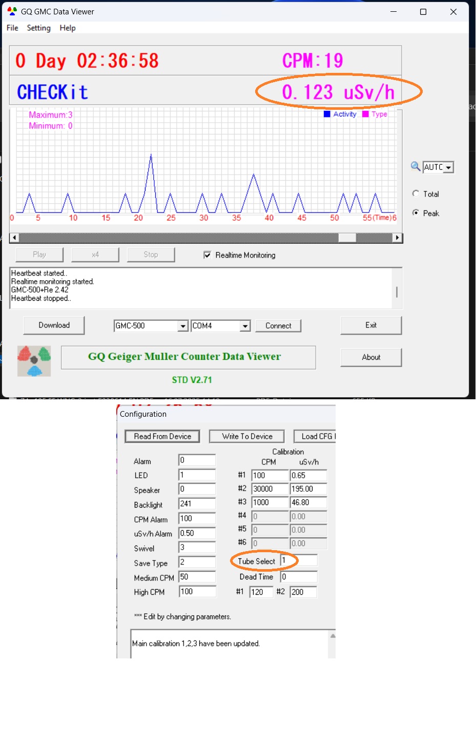

DataViewer is a realy nice part of software!
at moment i start to work with higher activity-probes,
for this i switch the counter-hardware to use "Tube2"-selection only.
but DataViewer mainscreen in realtime monitoring activ
still shows the uSv/hour-calculation based on Tube1-calibration :(
thats wrong - isn't it?
Is it possible to add a field on mainscreen where i can manually
fill in the calibration value, on which the realtime
uSv/hour-calculation should be based on?
if that field is empty, it can use the default Tube1 value,
this will match the most common use of Tube1,
but this is only my thinking...
i found right, on Configuration-screen after "Read from Device"
it shows under "Tube Select" value: 1
((also counter-hardware screen show correct counting on CPM2
and its correct uSv/hour-calculation))
but anyway, it still use on DV-main-screen this based on Tube1-calibration :(
kind regards
3z_phoenix
