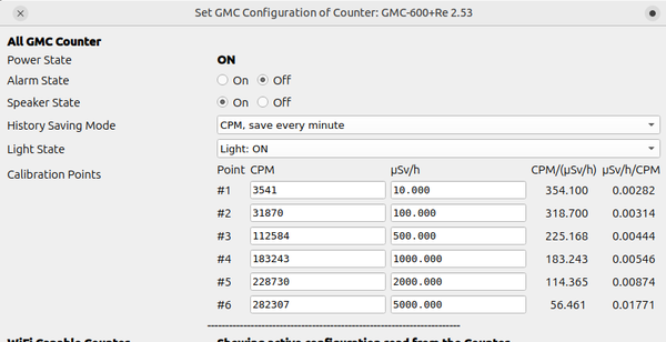

I found these "Calibration" numbers in a GMC-600 counter, firmware 2.53. My impression is that these numbers are rubbish. Could people with a GMC counter showing a 6-point-calibration please confirm them, or post their different numbers?
