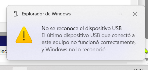

Hello. I am writting from Huelva, Spain. My english is what you can read, sorry for that. I have a little trouble here
Sorry but i don't have exactly the error/notification message in english so i think it is better that i write it like it is showed.

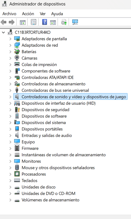

I research it in the system, a little. The Device Manager (Administrador de dispositivos, in the capture) not show Ports now when i connect the GMC-390v2.

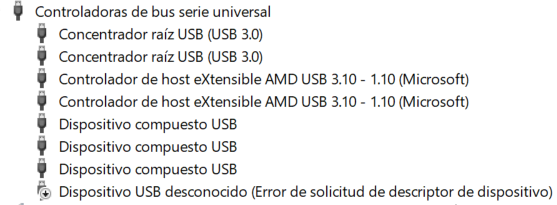

But in "controladoras de bus serie universal" appears the error
"Dispositivo USB desconocido (Error de solucitud de descriptor de dispositivo)" PLOP!

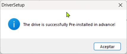

The drivers was installed:

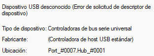

There are som images of devide properties
It say "Device descriptor failure".

can you go to Device Manager -> Add legacy hardware and try to install anything under ports to Ports section can appear on your device manager list.
