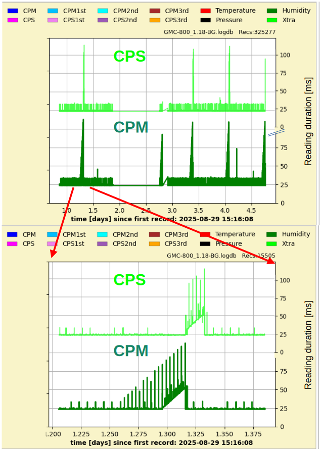

I am thinking about trying Radpro. But first I'd like to review the performance of the GMC firmware. Here is a first shot.
I am running the "GMC-800Re1.18" counter at background, and using GeigerLog 2.0 to measure the duration of a CPM and CPS call.
Most calls take around 25 ms, which is quite good! However, at rather regular intervals of about twice per day, the duration builds up, up to about 115ms, in a rather strange pattern. This is inconenient for reliable recording.
It looks like some firmware issue. Perhaps related to garbage collection?

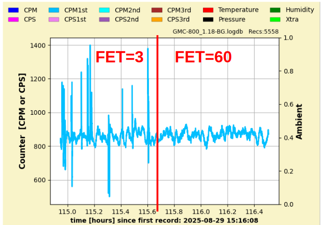

This awkward, ill-conceived FET ruins the day once again!
This is a GMC-800 with a Thorium source, creating something around CPM=900.
Don't use FET !!! You are creating Fake data!
Set it to FET=60 to switch it off.

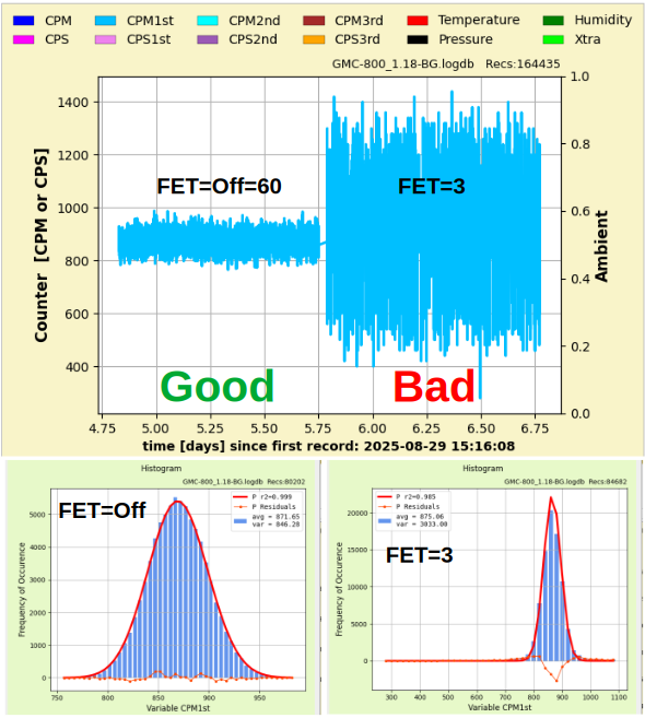

More on this hilarious FET:
With FET=60 it is switched off. Then - in this example - you see a random fluctuation between CPM=800 up to 950. Reasonable.
However, with FET=3 - at its default, worst setting - it fluctuates between CPM=400 and 1400!
FET is the worst feature stuffed into the GMC firmwares! It renders your data to fake data.

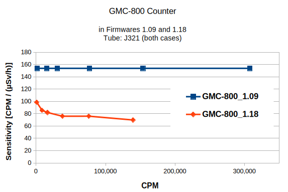

What a surprise! Using GeigerLog to look at the difference of "calibration" between a GMC-800 counter with either Firmware 1.09 and 1.18:
With firmware 1.09 each of the 6 calibration points codes the very same sensitivity of 154 CPM/(uSv/h). This value has been used by GQ for all tubes in their GMC-300, 500, 800 counters since the very beginning. And no matter what tube M4011, J321, J305 has actually been used in the counter (which is very strange as well).
However, now on FW 1.18 we find completely different values, but for the VERY SAME tube, how comes?
In particular, the new values signal that the sensitivity is only HALF of what it had been! So, from one firmware to the next, the tube has been downgraded about 2 fold, has become 2 fold less sensitive?

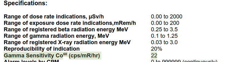

Let's see how this is explained in the manual. Looking into version Re. 1.04 May-2025 I find:
Converted into proper units this is: Gamma-Sensitivity=132 CPM/(uSv/h).
Why is this not matched with neither the old nor the new firmware? The new firmware numbers still suggest a 40% lower sensitivity than what is specified in the manual?
What shall we conclude out of this? You had wrongly overrated your counters' sensitivity by approx. a factor of 2? And we have to downgrade all measurements by this factor?

Interesting! I have FW 1.09.
The new sensitivity numbers look a bit like the ones here:
https://www.gqelectronicsllc.com/forum/topic.asp?TOPIC_ID=10612
Reply #55.
I already wondered where this discrepancy comes from...If I read the numbers in the above reply #55 correctly, the following sensitivities were obtained by NIST calibration:
CPM 960 --> 96
CPM 8991 --> 90
CPM 17115 --> 86
CPM 40079 --> 80
CPM 78848 --> 79
CPM 144614 --> 72
This seems to correlate with 1.18...
