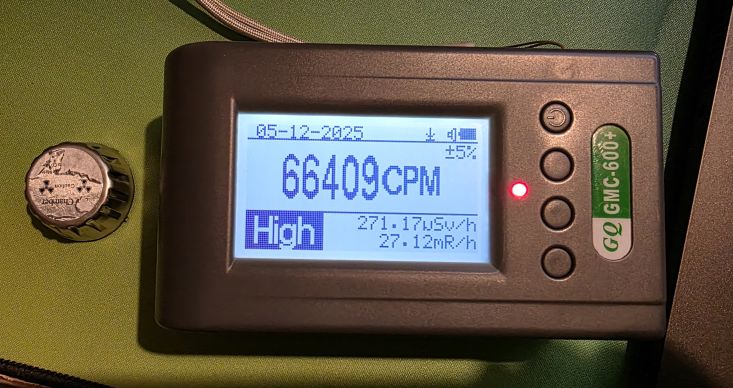

Do you have a smoke detector that you can use and play around with? If yes, then smoke detectors have a tiny bit of Americium 241 that you can put just in front of your counter and see what happens. Americium 241 is an Alpha emitter and if you carefully open the radioactive source and carefully place it on the counter detector, you should be able to get 60K CPM. Mine for example got 66409 CPM (271.17 uSv/h)
Edited by - ihab17 on 05/12/2025 04:54:26
