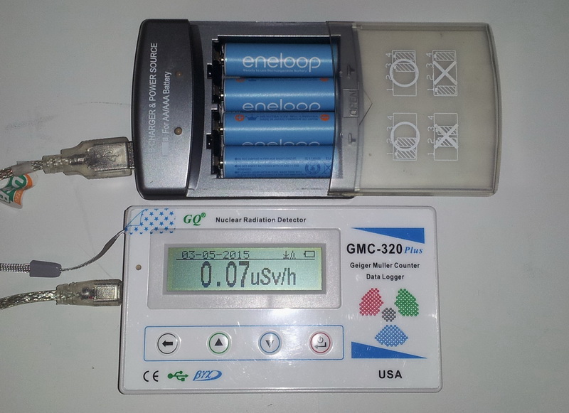

Tekkeon is working very well. Rated 1A. Charged from 0-100% in 2.4 hours from 4 Sanyo Eneloop 2000 mAh rechargeable batteries. There was still some juice in the Eneloop

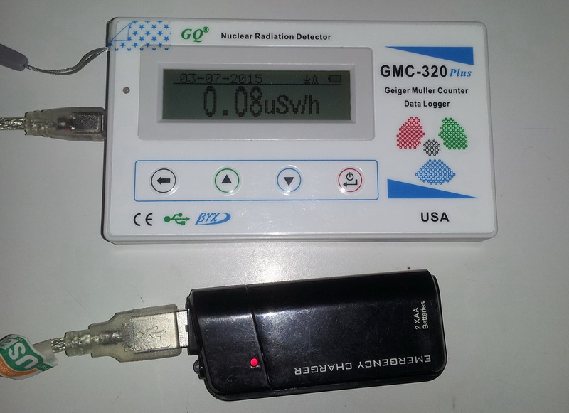

El cheapo charger with 2 Duracell Stay Charged 2000 mAh rechargeable batteries works great. Needs to be charged twice, two batteries are not enough. Charged from 0-100% in 2.5 hours. Still some juice left in last two Duracell.
