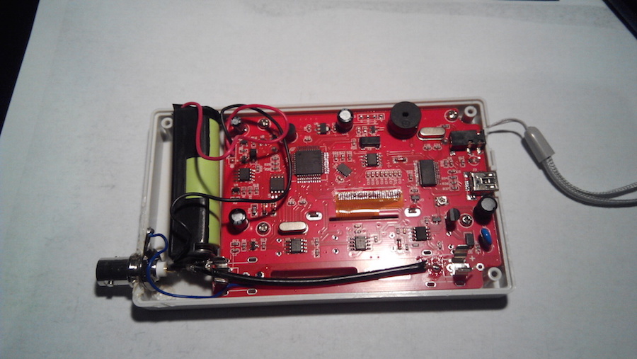

in last days i tried to assemble a new tube to the GMC.
It was a big SBT10a which i installed in a new case.
I used BNC-connectors to connect the GMC-320+ with the new tube.
You can see it on the picture.
It works great due to the big tube, but i have a little problem:
if i approach the tube and the case of the GMC-320 the counts increase about 30%. If i take it away, the additional counts are gone. The same happens if I measure pitchblende. By approaching, it increases about 30%.
I suppose that it is a problem of shielding the GMC. Therefore i used a coaxial cable even inside the GMC.
But still the same problem.
Does anyone have a idea?
Thanks for your help,
Regards from Germany,
Benedikt

I also see that you have failed to shield off the cable and are using a jumper. Nope! Carefully remove a small piece of covering off the cable to expose the shielding. Don't cut too deeply or you'll damage the cable. Then, carefully tin with solder the exposed shield. and solder to the board near the clip (negative clip) like you did for the positive lead. This grounds the shield more directly. Otherwise a lot of the shield is floating and acting as a variable parasitic capacitance. This is why your hand affects counts. Do same with tube as well. Shield to connector with only a small wire to the BNC ground.

If your cable is too long, parasitic capacitance will diminish the count frequency (Max CPM) or even fail to count at all. Try making connections as short as possible. RG174U mini cable is fine for this application, keep length below 400mm (I'd say no longer than 250mm to start)
