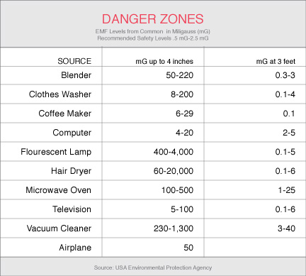

The char from EPA:
EPA EMF Information:
41338 bytes

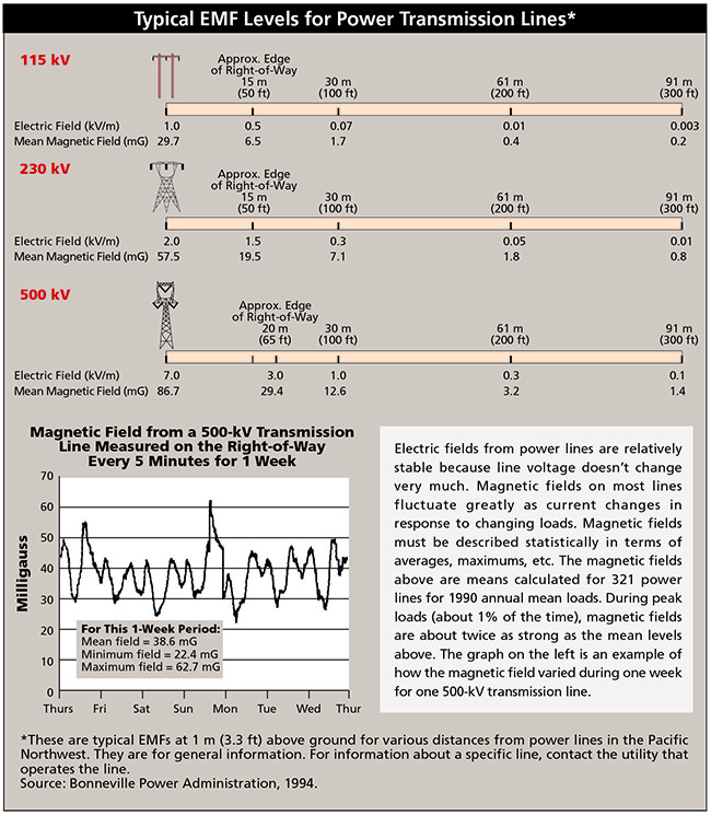

From US Government National Institute of Environmental Health Sciences (NIEHS),near a power line?
790774 bytes
