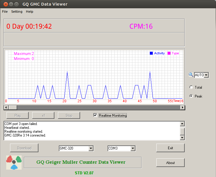

Hi,
After successfully installing GQ GMC Data Viewer in Ubuntu 12.04 using WINE I could run the software but got no connection to my GMC-320.
After issuing this command in terminal:
ln -s /dev/ttyUSB0 ~/.wine/dosdevices/com3
it works great.
HTH

hi,,im running ubuntu also,,how did you get it to comply with the unit?i wrote your task down but where do you input the data?in termal??wpould like to set mine up like you. thnx
