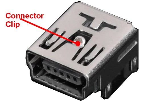

If the USB connection is "wobbly" or loose fitting, then it may due to the USB socket "connector clip" is loose.
Please check your GMC-300 USB socket with following instruction and push the "connector clip" down little bit.
