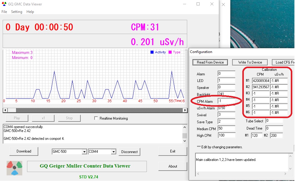

sorry to say, but DataViewer V2.74 is something honk :(
(also somewhere here is told that DataViewer is only for Demonstration)
i would not recommend to use, for not accidently write worst data
to device

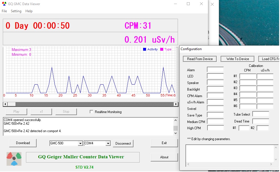

in first run after install, all looks good
but after Configuration / "Read From Device" it shows:
corrupted data under calibration,
and CPM Alarm: -1 (should be 100)
i did NO "Write To Device" !!!

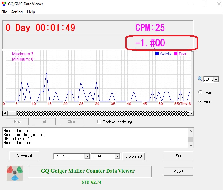

things go more worst after new activation realtime monitoring:
so i stay at moment with DataViewer V2.71
