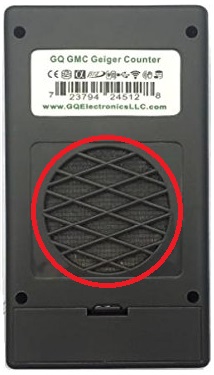

Has anyone disassembled the GMC-600+ device case? Where in the case is the Geiger tube LND 7317? Which side and where should the device be applied to the measurement point? I want to know not the approximate, but the exact location of the receiver. I would be grateful for a photo of the open case.
Posted - 07/22/2025 :  14:42:56  Show Profile  Reply with Quote
Sensor is attached to the back side of the case. Mica window is showing in the back for alpha detection.

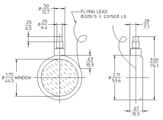

Thank you! I thought the tube should be cylindrical and elongated, like a felt-tip pen. But it turns out to be in the shape of a pill. https://www.youtube.com/shorts/zqmi3H0sXWY
1247 Posts
Posted - 07/23/2025 :  06:38:26  Show Profile  Reply with Quote
It is often called "Pancake Tube"!
