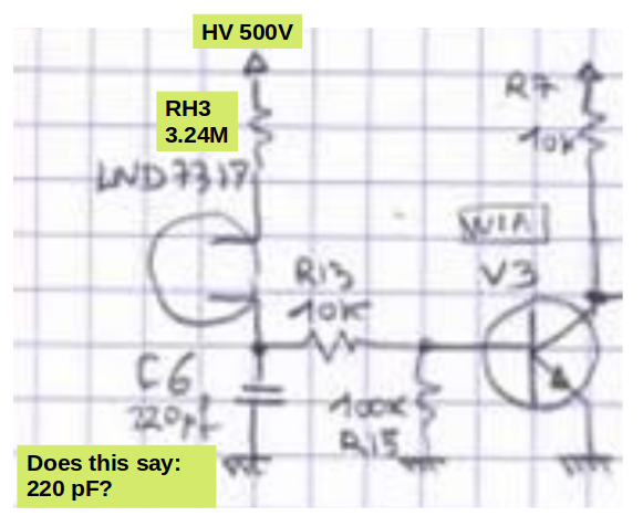

I am a new user of a GMC600+ and I am electronician (excuse for my bad english). I have opened my GMC600+ because I saw very often double counts on the total counting view, in a low level 0.2 uS/h, while bips was single. Il represented roughly 20% overcount ! After opening my GMC600+ it appears that parasitic glitches due to HV supply switching triggered additional pulses on the first transistor V3. I fixed this electronic glitche, and now the radioactivity level is minored compared to an other counter in ambiant levels.
I have seen that it is possible to recalibrate the GMC600+ by entering 3 couple values CPM<->µS/h experimentally.
Does anybody knows the 3 couples µS<->CPM values recorded in GMC600+ factory sofware ?
I can send to interested guys the hardware modifications and explanations in my GMC600+ I did to fix the glitches. Please ask me.

Hello and welcome to the forum. I also own a 600+ and I am curious what exactly did you do. I am not an expert in electronics like you, nevertheless I would like to know what did you do. Thanks

Hello Denis, I am an french electrician too, your modification is to enlarge C3?

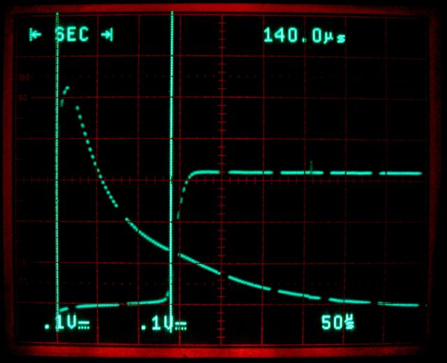

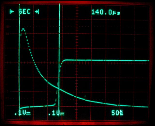

denistoulouse
17 Posts
Posted - 02/01/2023 :  05:31:07  Show Profile  Reply with Quote
Hi everybody, @Ullix,
Thank you for your quick responses. Thank you Ullix for your values.

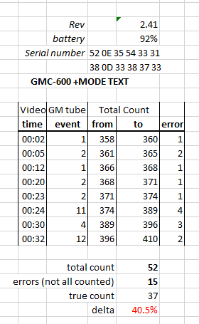

In fact, I saw that my GMC600+ surevaluates at about 20% the ambiant value with its double counts. You will see in the video and xls files inside the link below.
20% is just the ratio between 348 and 420 ! After fixing the double pulse I found 348 and 364 for the conversion factor !
On https://www.grosfichiers.com/nUDthbDYvZF you can upload my investigation files, please let me know what you think about it.
I have been very surprised to see on this forum GMC600+ indicating more than 2 000 000 CPM face to a cesium source, because as you see in my description, the filtered pulse in a standard GMC600 is roughly 150 µs ... 400 000 CPM maximorum theoric ...
Thank you. Denis

1241 Posts
Posted - 02/01/2023 :  07:35:58  Show Profile  Reply with Quote
@Denis: this is great information, and gives hope solve the mystery behind a stubborn defect which I have observed in GMC-600 counters.
While I think I get the gist of what you are saying, I am not "electric" enough to comprehend the details. I downloaded your data (thanks) but I am not even sure what your osci traces show, and where you see the double peaks, and when not, and what feature in the video hints at double-counts. Perhaps some arrows pointing to the relevant events or markers? Some "slower" explanation for those in need ? ;-)
But I am sufficiently "physics" to get a headache from wrong units:
Sv (capital S, small v) is honoring the Swedish physicist Sievert, and is a unit for radiation dose, the unit we would use to compare radiation sources and classify danger levels.
S (capital S only) is honoring the German engineer (and multi genius) Siemens, and stands for Conductance, the inverse of Resistance, like units 1 S = 1 / Ohm.

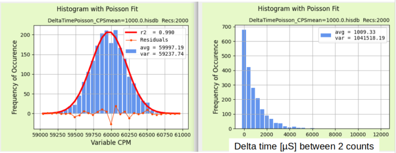

Back to the counter: I had noticed that it is not possible to get a clean Poisson distribution when a GMC-600+ was used to record counts, while GMC-300 and -500 counters, and several other counter brands, consistently come up with proper data. This has been discussed at length (with no conclusion yet) here: https://sourceforge.net/p/geigerlog/discussion/general/thread/0c5698d25e/ At this moment, I' say don't buy the 600. Wait until this problem is fixed.
With your discovery we may get a new handle on this issue.
What I very eagerly want is that you run your counter while recording data using my software GeigerLog ( https://sourceforge.net/projects/geigerlog/ ) and let me have the data.
Two runs would be needed, each for about 5 hours at background rate with 1 sec cycle time:
#1: the counter is exhibiting the glitches
#2: the counter is "repaired" and is NOT showing the glitches.
There are other issues, like pulse length: The tube manufacturer specifies a minimum dead time of 40us; not in agreement with neither 140us, nor with 5us! But we can let this rest for another day.
denistoulouse
17 Posts
Posted - 02/01/2023 :  10:44:28  Show Profile  Reply with Quote
Hi Ulix,
Thank you for your precision on the "s" of Sv. May God bless the geniuses, and that men honor their geniuses as Gods.
It's my turn not to be a specialist in statistics and radioactivity measurements, but clearly random and frequent double counts like my GMC600+ (perhaps a simple electronic anomaly of mine, but I have my doubts...) , at a potential recurrence of 400 µseconds, (rhythm of the parasite of the HV power supply) must introduce a bias into the statistical curves. At very high radioactivity, we could have a systematic addition of counting, 1/400µs would give +150000 fictitious CPM !
On my video, you have to look at the "total count" line while listening to the audio clicks of the counter. Despite the small delay in updating this line by the GMC600+, we often see isolated clicks turn into a +2 count! watch the video again with that eye!

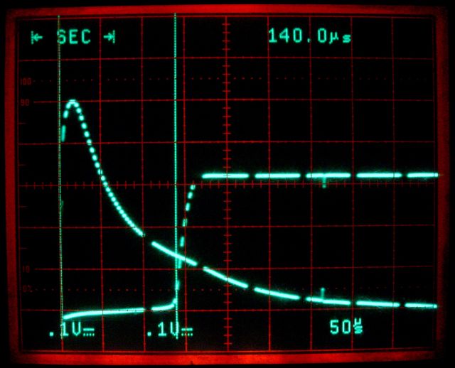

I checked the calibration of the GMC600+, it is set at 348cpm/µSv/h and not 420. At room temperature, it now gives the same values as my quartex RD1503.
I also saw that we can define the dead time of the tube, defined at 270 µSeconds in my GMC600+, and the possibilit to take it into account or not for the measurement.
By observing the pulses at the output of the tube with the oscilloscope, they are of the order of a few tens of microseconds when I have removed the capacitance. I don't know how the GMC600 software takes this dead time into account, when it is set to be taken into account?
If the forum was HTML, I could include pictures to comment !
Thank you for this exchange Ullix.
Denis

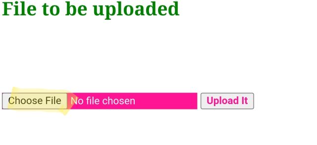

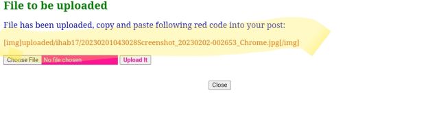

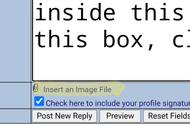

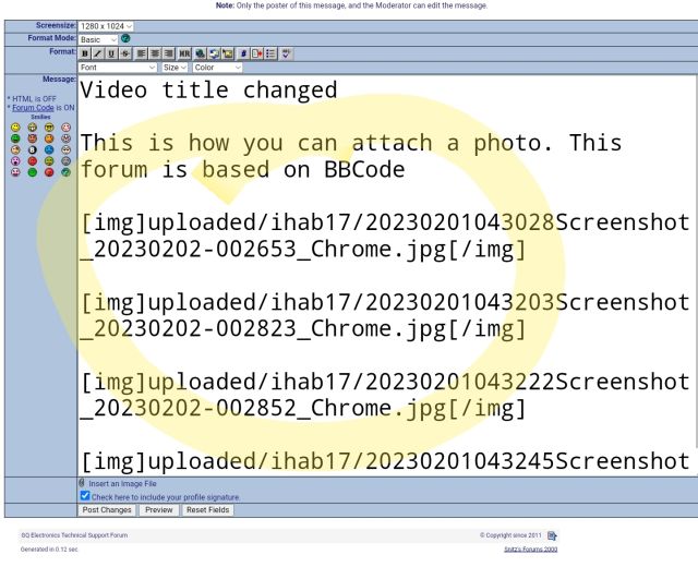

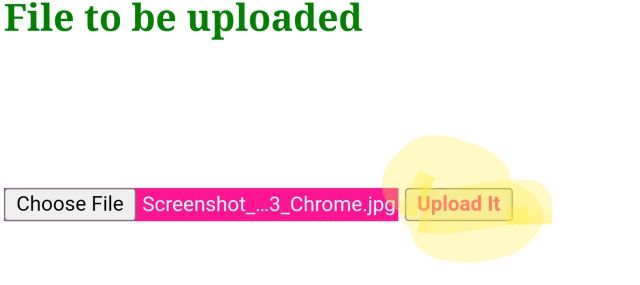

By the way, this is your video https://www.youtube.com/watch?v=DGkwgmeyCOU and these are your images
Sorry for the large images... @Ullix don't get upset!
Here are some high resolution images of the internals of the counter
https://www.amazon.it/photos/share/VrkP3r4b1GzSCQ1I1z505KL2Ex03t0z6KTGJGyC7Jhj

Video title changed
This is how you can attach a photo. This forum is based on BBCode
Hint: your images must not contain spaces in the file names. Just rename them BEFORE you upload them
With that explanation I now see what you mean. It could be an indication, however, this evidence is weak. For anything of a Poissonian distribution the time difference between 2 successive counts is distributed exponentially, as in this picture showing synthetic data with a CPSmean=1000:
Left side shows the CPM, right side the Delta-Time. The first Delta-Time column has 1/3rd of all counts! Counts coming close together is the nature of the beast; jumping by 2 counts is not unexpected. Your osci pics might be stronger evidence, but how can you conclude that a second pulse is due to the High-Voltage power supply starting a regulation cycle?

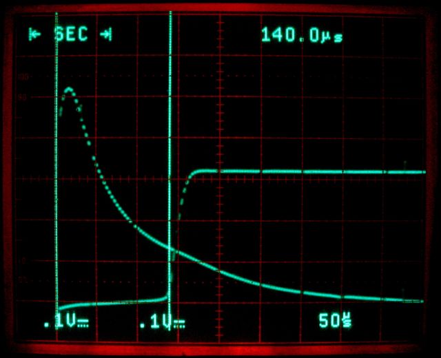

As an example for double-counts: here is a pic from an old experiment on GMC300E+ with tube M4011.
This and more on it in this topic:http://www.gqelectronicsllc.com/forum/topic.asp?TOPIC_ID=4598
I can't tell when the second event becomes detectable.

1-> On my video, the small excel table indicates where obvious doucle counts can be seen. For me it is far too much than natural in one minute.

about the enlargement of the pulse and the deadtime:
(-) one thing that certainly everyone knows:
when a particle is detected it causes a short circuit in the tube, it discharges then recharges, the pulse that we observe is on the measurement of the current crossing the tube (charging current in fact)
we know that when the tube is not charged (under a certain voltage) it cannot detect new particles. we then speak of dead time, then we make a statistical correction based on the fact that we did not observe the total over a full second or a full minute minute.
(-) another thing:
Now what happens, the counter enlarge not the current pulse but its measurement with a capacitor. Ohhhhhh
this means that the pulse will be active for 140uS it is longer than the dead time of the tube which is 40uS this means that the pulse will remain active even when the tube is already recharged and is able to generate a new pulse, if the tube generates a new pulse while the old pulse is still active, the two pulses will merge and only one will be observed.
ditto if there are many more pulses all within a maximum of 140uS of each other, we will see only one because C6 will remain charged (over 0.6v) all the time.
Edited by - Damien68 on 02/02/2023 06:54:36

Do I get it that C6 is then a MUST HAVE for the counter to work properly or a nice to have component that might help with high count levels? Because, if I am not mistaken, Denis shorted it, hence as if it not there. Illuminate me
I don't know, but based on the Denis's scope the pulse is too enlarged, and it shouldn't be distorted at all, maybe after (to garanteed a few uS) if necessary for the microcontroller, but in a more controlled way.
EDIT:personally after reflection I think it's better to derive the signal that's to say catch its variations (rising edge and falling edge), and not integrate it as is done by C6.

No, they don't illustrate what you wrote!
It is nothing parasitic, it is plain old radioactive decay governed by Poisson distribution. Look at my Reply#33: The succession of pulses is determined by an exponential distribution, i.e. the majority of pulses come in close succession. It just so happens that sometimes the second pulse is so close that it sits on the previous pulse's tail.
This is NOT an indication of something wrong with GMC-600+!

"Electricians" to the rescue - help is needed:
Here is an annotated cutout from Denis' notebook:
I do see two intertwined RC-networks:
The first is made up by RH3 and C6. When the tube fires its resistance becomes nearly zero, so C6 is charged from HV via RH3. The time constant is R*C=3.24MOhm*220pF (did I read the 220 correctly?) = 713us. Uiiih, this is a long time when we talk about native tube pulse lengths of 40us!
The 2nd RC-network is C6 and R13+R15. This forms a time constant of 220pF*110kOhm = 24us, which is more in line with the expected time constants. (This ignores influence of V3; if V3 had to be included, the time constant could only be faster.)
In combination we have the slow charging of C6 for the duration of the tube pulse of 40us, while at the same time a fast discharge via (R13+R15).
At this point my electric competence is fading a bit. What is the combined effect? Can this be calculated? Is there some simulation possible? Perhaps even online?
Given that Denis observes pulse lengths of 140us, it looks to me like tube performance is castrated a bit; it could be made faster, and support higher count rates. Or not? After all, the tubes native pulse length is only 40us!
But it also does NOT look like a defect in the GMC-600 design. Or does it?
P.S. I love the pics in Ihab's posts ;-))

Hi all,
1/ @Ullix,
You should simulate this network with the zero ohm (some micro secondes) tube when it occurs a particle. Without C6 (yes it is 220 pf) you would see a RH3/110ko *510V = 16Vpulse a the tube out. With my oscillo I observed rather 35V pulse. I should have taken photos but I have to open again the GMC600 :-(. Please believe me.
When you place C6, this pulse is decreased to 6Vp but enlarged.
Please do the experiment, but before you have to protect V3 by changing R13 R15 as 2100k/3k9. The glitche at a constant rate of 400µs is not a double particle ... Please look at again the video compare light and total count ...

Hi Denis,
if you measure a 35v pulse, it may come from the tuning of the probe of your oscilloscope, in the probe there is a adjustable capacitor which forms a capacitive divider with the non-normalized capacitance of the scope input.
Edited by - Damien68 on 02/03/2023 10:06:17

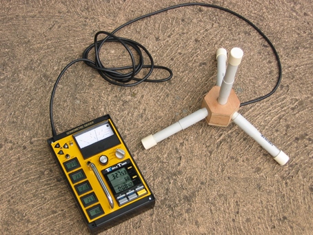

Hi ihab17, thank you a lot for your tuto on HTML editing !
To check if I am OK with it, I send a picture of my geiger goniometer !
I did a preview and had to reduce it :-)
I recommand your video tuto, nice to you ihab17 !
Denis

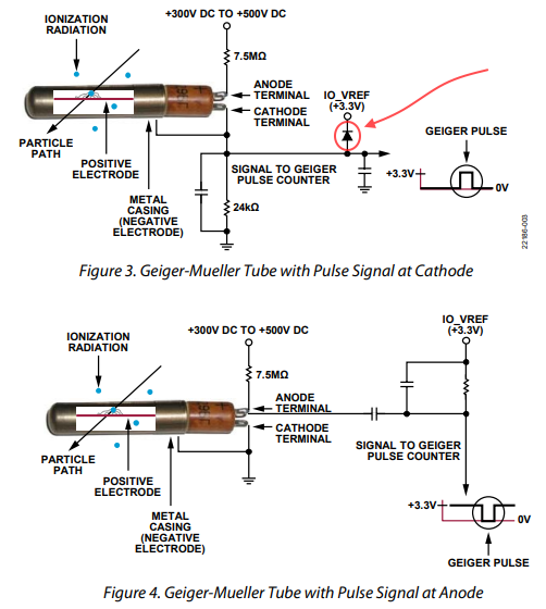

Wow I just retired this week from 39+ years working with and around Medium and high voltage equipment at power plants as an operator and Electrical and mechanical technician. This discussion is more than interesting and I wish we had a full schematic of the 600+ to reference but I assume it's Propitiatory.
I would often find impending equipment failure by the actual electrical "noise" the equipment was generating. I see a similarity here. I use my 600+ for searching and validating antiques that I collect. Many times while the speaker was enabled (mostly not so as not to gain attention) I would notice clicks that would occur as a quick burst I always thought this was due to "random decay" events but it has happened numerous times and always in the same manner and after reading the posts here I now believe it may be connected to a poorly designed HV power supply as seems to discovered by forum member Denistoulouse.
I found an article here that may shed a bit of light perhaps?
[https://www.analog.com/en/design-notes/bias-supply-powers-lowpower-geigermueller-tube.html]
With no 600+ factory schematic it's hard to say if it's an over all design error or just a few component issues that may be the possible cause if in fact it is really a HV PS issue. I won't even dare go into the software/firmware aspects.I will let you engineers handle it I am just a simple Power Plant technician now retired collecting antiques LOL!
Great Discussion, Great Forum and Greater Members!
Bob

@ Bobakman,
thank you for analog application note. I found this one too
https://www.analog.com/media/en/reference-design-documentation/reference-designs/cn0536.pdf
They use the same principle, with a voltage regulation at the first diod elevator stage only to not have a too high leakage current on 500 V.
Denis

Originally posted by denistoulouse
@ Bobakman,
Denis
@denistoulouse, on the Analog-Devices app note, they placed a diode to limit the height of the pulse to 3v3+0.6v and directly reduce the capacitor discharge time.
following the same idea, if I had a 600+, I would have tried to place two diodes in series between the cathode of the tube and the ground of the PCB to limit the pulse to 1v2, and adjust resistor and capacitance values to this new configuration
personally I prefer to take the pulse on the anode as in their second diagram, but their second diagram is not perfect because their capacitive divider will place a capacitive load directly on the anode of the tube which is not good at all . to take the signal on the anode it is better to replace the 7.5M resistor by two resistors in series to form a first resistive divider and connect the detection cap to the midpoint of these 2 resistors. for example taking 330kohms and 6.8Mohms to divide by 22
but taking the pulse on the anode makes it more sensitive to noise from the HV generator so it's require additional filter on the high voltage générator output.
Edited by - Damien68 on 02/05/2023 02:10:13

Yes the diode solution is attractive, but it is not very robust to EMC. When the diode does not conduct in the absence of detected particle, the output of the tube is maintained by 24 Ko and the capacity.
In the event of radiated interference, the base of the transistor may trigger interference pulses. In my proposed solution, the resistor R15 lowered to 3k9 is very low impedance whatever the case, which ensures increased robustness to local interference.
In addition, I would not put any capacity in order to keep the duration of the pulse of the tube minimal.
In case of EMP pulse >:-S, my diagram should survive and count the particles while in the other solution, the diode and the transistor might be blown :-)
As someone would say: "Mastery is acquired by studying, with everything becoming simple"
