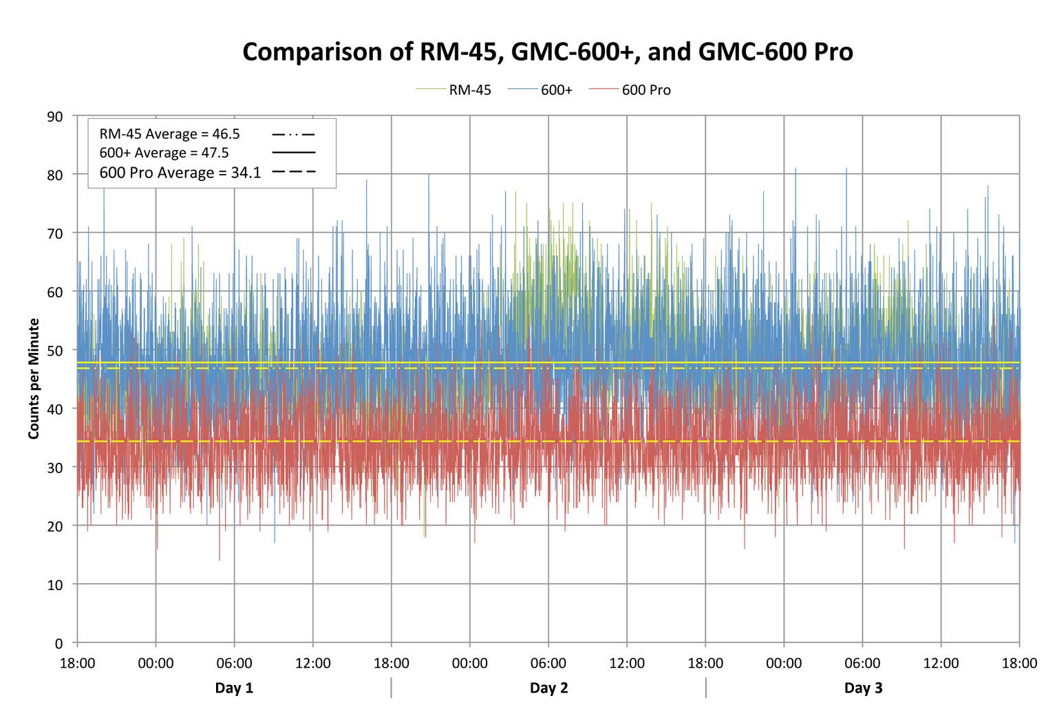

I recently purchased a new GMC-600 Pro directly from GQ Electronics. I already have a GMC-600+ and a Black Cat Systems GM-45. Just as with both the GMC-600+ and GMC-600 Pro, the GM-45 also uses the LND7317 "pancake" detector.
Soon after acquiring the GMC-600 Pro, I noticed that it seemed to be reading anomalously low. Just to check, I logged all three detectors continuously for three days. I placed all three detectors side-by-side on a table with the LND7317 windows facing up and nothing (except the table) for several feet in any direction from the detectors. Over the three day period, the GMC-600+ recorded an average of 47.2 CPM, the RM-45 recorded an average of 48.2 CPM, while the GMC-600 Pro recorded and average of 34.0 CPM.
In other words, over the three-day period, the GMC-600+ and the RM-45 recorded averages within 2.3% of each other, while the new GMC-600 Pro recorded approximately 28% less (it recorded a three-day average that was only 72% of the other two detectors).

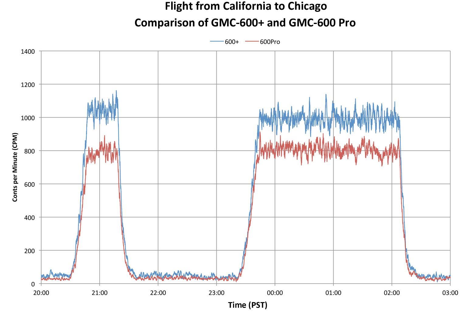

Soon after, I took the GMC-600+ and the GMC-600 Pro on a commercial aircraft flight from California to Chicago and back. I placed both detectors side-by-side in my nylon-sided carry-on bag which I placed in the overhead storage. Both units had the LND7317 windows facing up and had nothing except one thickness of nylon (the top of the bag) over them. The one-hour running average (OHRA) readings from the GMC-600 Pro, both on the ground and at altitude and on both flights, were consistently only 70% to 74% of the OHRA readings from the GMC-600+.
While I don't have any calibration sources, I assume that since the readings from both the GMC-600+ and the RM-45 have historically been similar (within a few percent of each other), the new GMC-600 Pro is giving anomalously low readings.

Your question relates to multiple issues.
First, on any GMC counter the first thing you should do is to switch off the dreaded FET option - this may ruin all your data. It is switched off when set to 60!
Second, no two counters give the same CPM values, even when of the very same make! Comparing the uSv/h (micro-Sievert) values is the only valid way for comparison! But note 2 things: first, this not possible unless each counter has been correctly calibrated. And I am almost sure that neither counter was, because it costs quite a few extra bucks to do it in a reputable lab. And second, this calibration is valid only, O N L Y when your radioactive sample is a pure Gamma emitter. When it also emits betas - most samples around hobbyist do - a uSv reading is INVALID and can never be compared between counters!
Third, the radioactive process can be described by a Poisson distribution. Human beings cannot tell whether any of the data scatter has a Poisson property. But software can tell. To my knowledge, the only one useable is my GeigerLog software. You find it here (it is open source): https://sourceforge.net/projects/geigerlog/
Load your data, then click "Poiss" to run a Poisson test. Data are ok when you get such a result, no matter how weird the data may look like;
And lastly, nice flight data! I'am collecting such stuff for hosting on my GeigerLog site. When you are ok with, please post the raw data!

The Fast Estimate Time was indeed set to "Dynamic" on the 600 Pro. I have now set it to "60 Seconds."
I have no way to know, but like you, I doubt the counters were ever calibrated. I've converted the CPM values to µSv/hr using the values I back-calculated from each of the counters. The 600+ appears to be using 380 CPM/(µSv/hr), while the 600 Pro appears to be using 355 CPM/(µSv/hr). The Black Cat software for the RM-45 uses a value of 300 CPM/(µSv/hr). Comparing the µSv/hr values for the 3-day run, the 600 Pro still appears record an average value about 23% lower than the 600+.

On the flight data: Yes, I would be glad to send you the data files. I have a record of my recent flights from California to Chicago and back, and also 2019 flights from California to Poland and Ukraine and back.

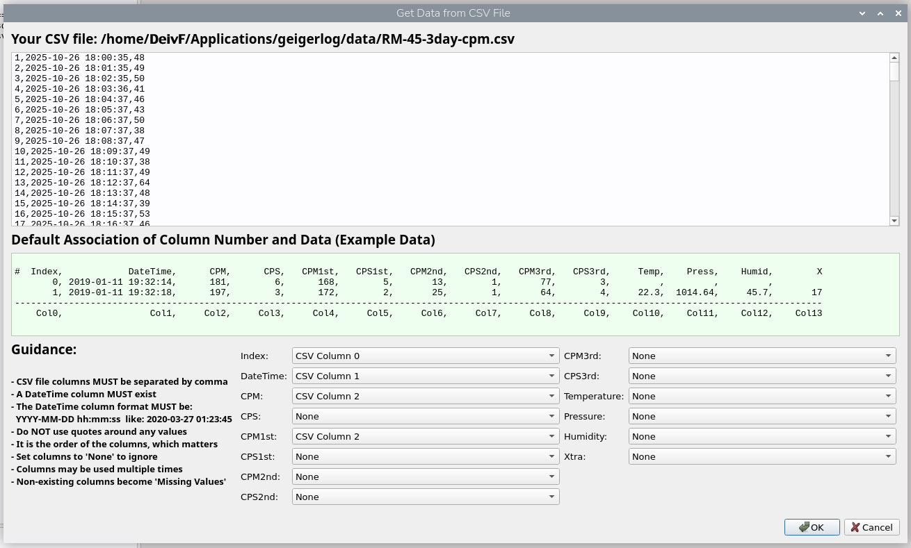

I have made some progress on loading the RM-45 data into GeigerLog. For some reason, GeigerLog was crashing when I attempted to import a .csv file form my ntwork server. However, when I copied the file to the GeigerLog local data directory, it appeared to be able to read the file. The dates appear to be formatted correctly and I am able to designate the column associations:

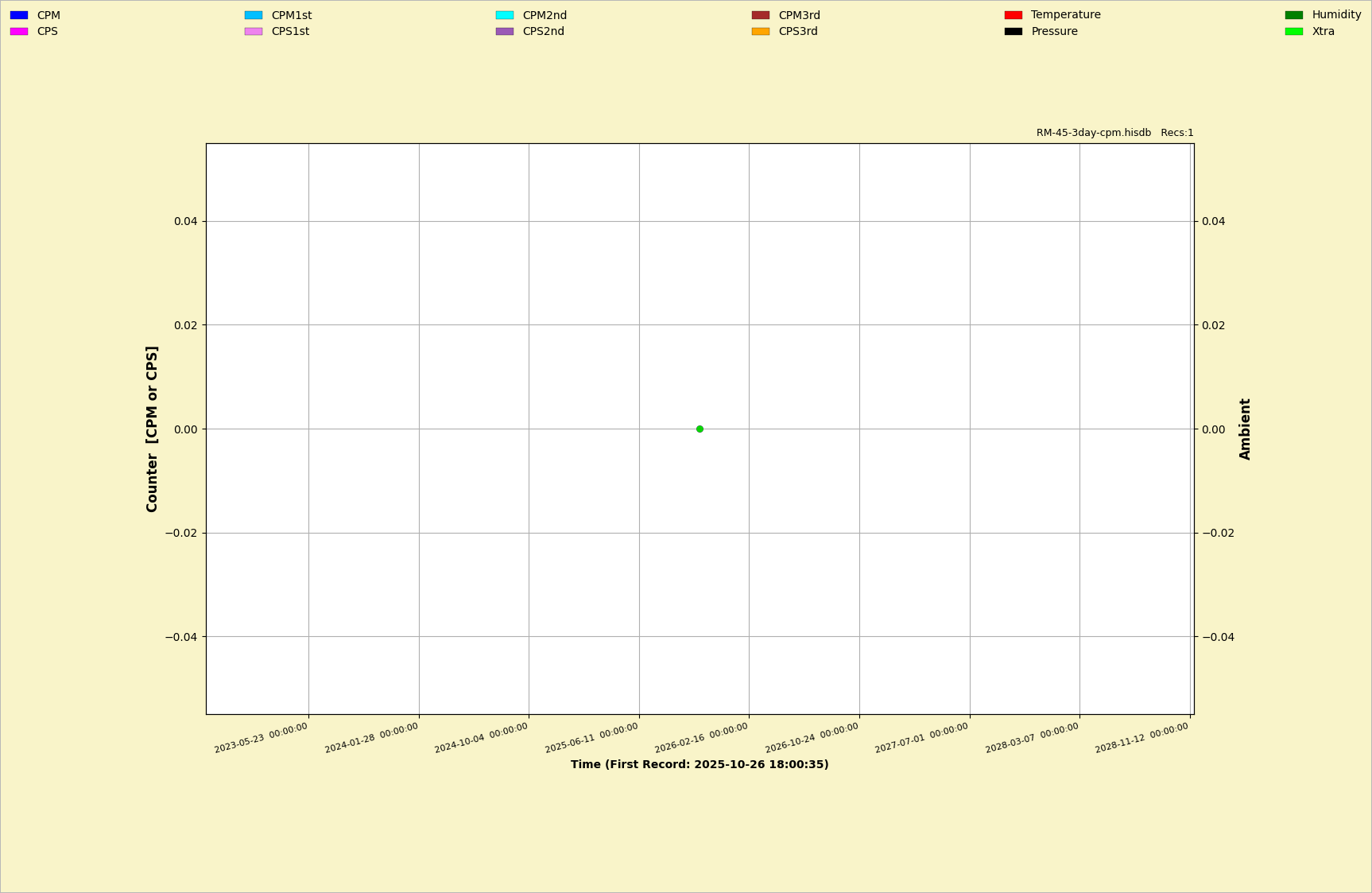

After clicking on "OK," however, GeigerLog appears to read only the first line into the (note the "Recs: 1" in the graph window):
Selecting "Show History Data" shows only one line of data:
==== Monitor Server =============================================================
Auto-Started Monitor Server at: 192.168.1.174  Port: 8080
==== Get History from CSV File ==================================================
History database: /home/DeivF/Applications/geigerlog/data/RM-45-3day-cpm.hisdb
Creating from file /home/DeivF/Applications/geigerlog/data/RM-45-3day-cpm.csv
==== Plot Data ==================================================================
from: /home/DeivF/Applications/geigerlog/data/RM-45-3day-cpm.hisdb
==== Show History Data ==========================================================
from: /home/dlfowler/Applications/geigerlog/data/RM-45-3day-cpm.hisdb
#   Index,            DateTime,      CPM,   CPM1st,   CPM2nd,   CPM3rd,     Temp,    Humid,     Xtra
        1, 2025-10-26 18:00:35,     48 2,     48 2,      nan,      nan,      nan,      nan,      nan

Success at last. I changed the end-of-line characters in the file from "carriage return" (<cr> - hex 0D) to "line feed" (<lf> - hex 0A), and the file imported correctly. So it appears that, at least when running GeigerLog on a Linux system, the .csv file must be on the local file system and must have unix-style end-of-line characters.

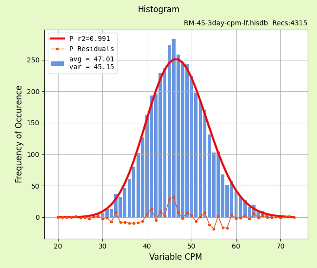

So, after all that, this is the Poisson graph for the RM-45 recorded over the same 3-day period as the 600+ and 600 Pro:
The data for the RM-45 is somewhat more course than for either the 600+ of 600 Pro because while the 600+ and 600 Pro logged one data point per second, the RM-45 recorded only one data point per minute.

Well, look at that: Nothing but random scatter, as the thin-red residual line shows!
A clear proof that the Geiger tube LND7317 is working just fine - if the device is constructed properly! And this is NOT the case with BOTH GQ-600 counters! One of them is bad, the other very bad.
I am showing this for years now, alas ...

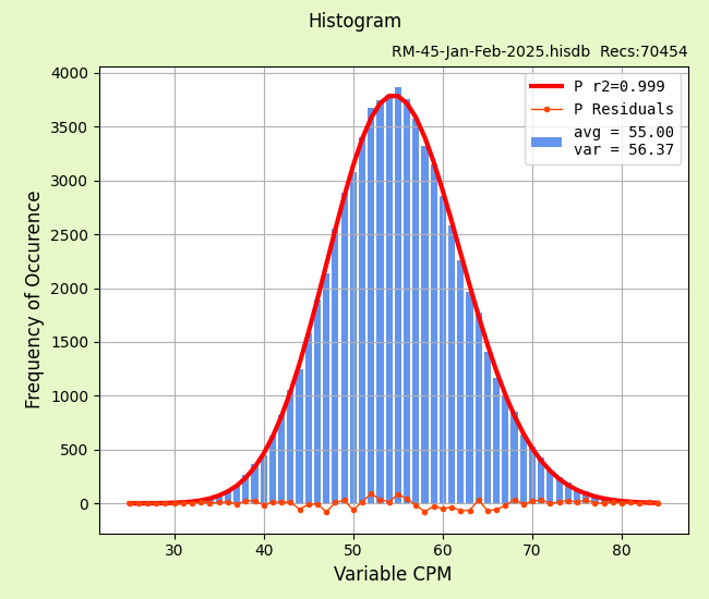

Here is the Poisson graph for the period from 6 January through 24 February of this year (a period between software crashes, one data point per minute).

Excellent data! That is how it should look like when all is well!
So a One-Man-Shop from yesteryear was manageing perfectly well what a modern shop is unable to do for many years. I am now even more curious how the internal connections to the tube look like,in comparison to the defect GMC-600 counter! Can you read off the value of the anode resistor in the GM-45?
With the new name Google was able to find even some pictures. Hmm. I don't see a design award coming, but the engineering surely was done right.
Any count from the detector is sent as a single byte over the serial line to the computer.
That feature is also available on GMC counter (at least had been). It came seriously in the way of some people, so GeigerLog is switching this off at every start. Nevertheless, it can / could be used.
A variant of this is also supported on GeigerLog. Look for chapter "SerialPulse Devices". It uses just such a USB-to-Serial adapter, and you feed the serial end with pulses. As the bytes going through are collected in a Serial Buffer, GeigerLog can leisurely collect the bytes every second. So yes, CPS resolution is easily possible!
With a dead-time of the tubes in the range of 100...200 microsec, this gives a max CPS of 10000. The USB chips and Serial lines can handle at least 20 times this rate. Even a Raspi can handle red-hot-burning Geiger Counter pulses!

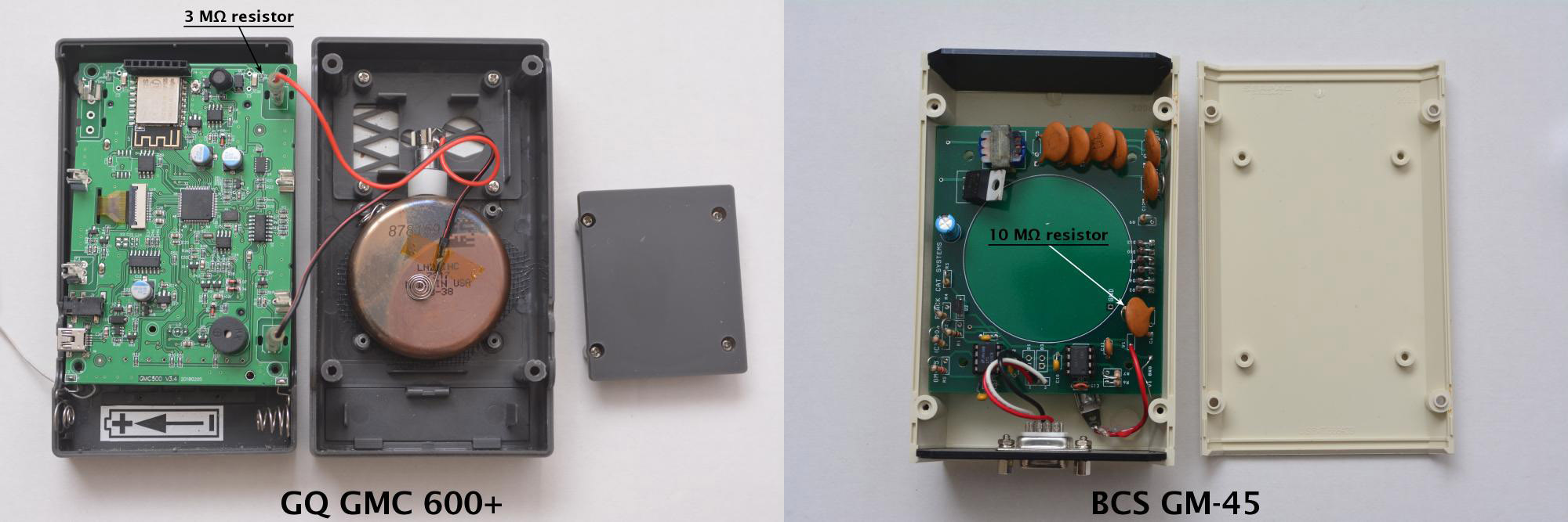

The inside of the GM-45 is rather "old-school" with standard resistors and capacitors. The resistor on the anode of the LND7317 is 10 meg-ohm, 1% tolerance (brown-black-blue-gold).
The resistor on the LND7317 anode in the GMC-600+ is a surface-mount 3 meg-ohm ("305").
Since the GMC-600 Pro is brand new, I don't plan to open it while the warranty is active.
1247 Posts
Posted - 11/24/2025 :  00:03:29  Show Profile  Reply with Quote
10 vs 3 is quite a difference, but is that the cause for the 600 problems?
How good are your electric skills? Can you add 7Mohm to the anode resistor? I believe there is a connector on the board, to which the anode wire is connected. It can be disconnected, and a resisitor can be clamped in between the on-board-connector and the wire.
Then do another Poisson check.

Yes, the LND7317 in the 600+ is connected to circuit board by spade ("tab") connectors. It would be easy to unplug the anode wire and insert a resistor in line, but I don't have any 7 meg-ohm resistors and there aren't any electronics parts shops in my area. It's a small item, but it may take some time to receive one through ordering online.
I have one question, though. The LND circuit examples show a resistor pair with a 10:1 ratio and a 50 pico-farad capacitor branching off in-between them. The circuit diagrams show two examples, a 3.3 M-ohm : 330 K-ohm pair and a 4.7 M-ohm : 470 K-ohm pair (both examples show a 50 pf capacitor branching between). Assuming the 600+ uses a similar circuit so that the 3.0 M-ohm resistor is paired with a 300 K-ohm resistor, will more than tripling the resistance of one side of the circuit without changing the resistance of the other have the desired effect?

What I can tell with certainty is that GM-45 does it right, and GQ does it wrong on both their 600s!
Since you say, the GM-45 uses classic circuitry (photo, please?) can you tell what Resistor/Capacitor circuitry they use? And what the 600 is using?

Other than the first resister and capacitor from the anode, it's difficult to follow the traces to try to decipher the rest of the circuit. I can check the value of the ceramic capacitor branching from the anode resistor of the GM-45, but the capacitor in the 600+ is a surface mount with no indication its capacitance.

I have no answer for the different readings. CPM=47 vs 34 over 3 days does indeed look significant. Different shielding? How do the frontside of the 3 counters look as seen from outside?
Re the 45: There seems to be an old serial connector at the boottom. Was is its purpose? Not for power delivery? I see no battery?
The red wire at the bottom right does seem to go to the anode. I can't see a cathode wire?
Re the 600+: The tube wiring is significantly different from the 45! And this may be the culprit for the messed up Poisson test. The two wires stick together for a good part of the rather long length of the wire. Note that the anode wire for the 45 is much, much shorter!
The length of the tube wiring in the 600+, and in particular the closeness does increase the capacitance of this arrangement. And capacitance is known to distort the signals. I have demonstrated this quite some time ago.
I suggest to separate the red from the black/purple (?) wire, and lay the two wires as far apart from each other as possible. Then run the counter and do a Poisson again.

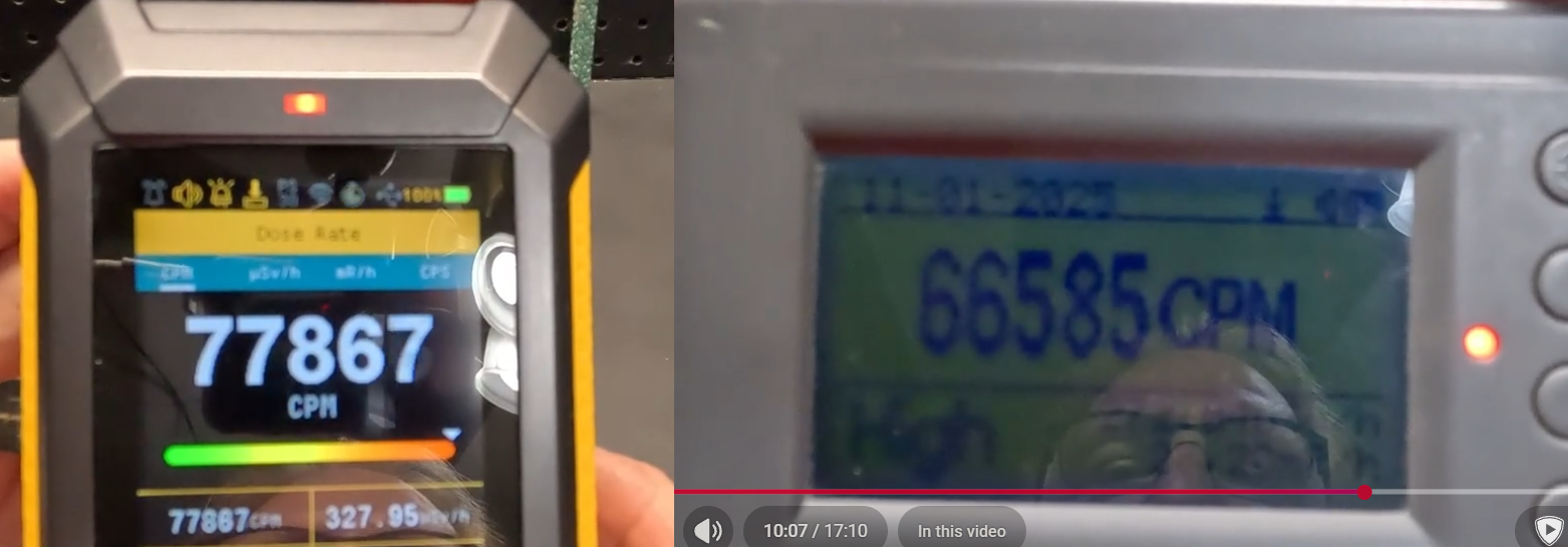

Hi! Just to add another (single) data point to this discussion:
https://www.youtube.com/watch?v=BXazp-GACHU
In this comparison video the GMC-600 Pro also reads consistently lower than the GMC-600+.
Could it be as simple as the GMC-600 Pro having a more hefty metal grating over the "pancake" detector as seen in the video at time stamp 15:59?
Edited by - kwinz on 02/23/2026 11:01:45
Posted - 02/23/2026 :  16:59:49  Show Profile  Reply with Quote
From the video, the first test (compass) showed higher readings on the GMC-600PRO than GMC-600Plus. Technically, they should have similar readings as long as the test is done at the same location/position from the sensor.
kwinz
Austria
Posted - 02/24/2026 :  00:41:31  Show Profile  Reply with Quote
Thanks for the reply EmfDev and giving your opinion on the video!
I wouldn't place too much weight on the first test in the video, because (1) the compass was the item that seemed to be the most sensitive to probe placement, and the GMC-600Plus was held onto the compass for shorter. The author of the video even mentions this: "I'm sure it will creep up to the same value".
