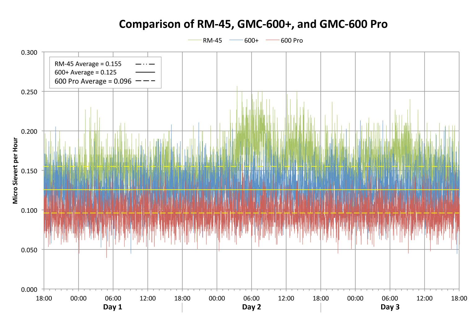

Soon after acquiring the GMC-600 Pro, I noticed that it seemed to be reading anomalously low. Just to check, I logged all three detectors continuously for three days. I placed all three detectors side-by-side on a table with the LND7317 windows facing up and nothing (except the table) for several feet in any direction from the detectors. Over the three day period, the GMC-600+ recorded an average of 47.2 CPM, the RM-45 recorded an average of 48.2 CPM, while the GMC-600 Pro recorded and average of 34.0 CPM.
In other words, over the three-day period, the GMC-600+ and the RM-45 recorded averages within 2.3% of each other, while the new GMC-600 Pro recorded approximately 28% less (it recorded a three-day average that was only 72% of the other two detectors).

I have no way to know, but like you, I doubt the counters were ever calibrated. I've converted the CPM values to µSv/hr using the values I back-calculated from each of the counters. The 600+ appears to be using 380 CPM/(µSv/hr), while the 600 Pro appears to be using 355 CPM/(µSv/hr). The Black Cat software for the RM-45 uses a value of 300 CPM/(µSv/hr). Comparing the µSv/hr values for the 3-day run, the 600 Pro still appears record an average value about 23% lower than the 600+.

Using the GQ Electronics default sensitivity values, the 600 Pro still records a µSv/hr average that is approximately 23% less than the 600+ in the same location, recording for the same duration. Using the LND7317 manufacturer's sensitivity value, the 600 Pro records an average that is approximately 28% less than the 600+.

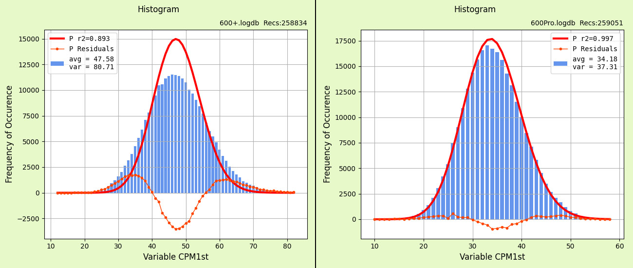

I attempted to post the Poison graphs for both logs in my previous post, but apparently the forum did not like the "+" (in "600+") in the file name. Here are the Poison graphs from the 3-day logs (using a re-named image file):
