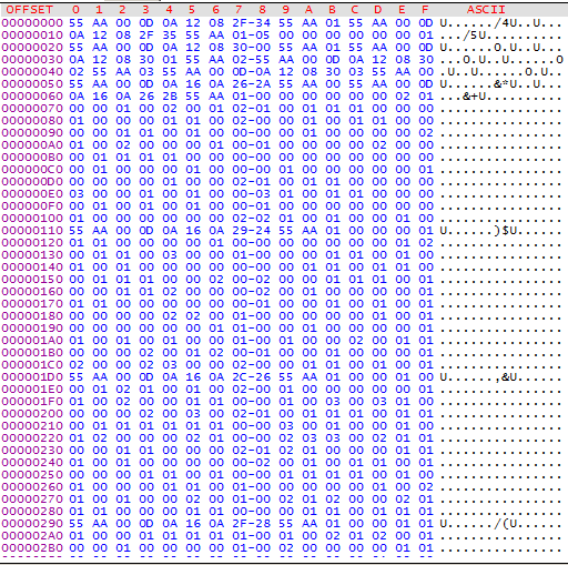

Here is an example of a binary data file opened by a binary file editor:
23.73 KB
The data 55 AA 00 three bytes indicate a timestamp started. A timestamp total 12 bytes long. The last three bytes 55 AA 01 indicated a Every Second data type data started. 55 AA 02 indicated a Every Minute data type data started. 55 AA 03 indicated a Every Hour data type data started. 55 AA 00 indicated data save feature is off.
In this data file, the first date and time data are: 0D 0A 12 08 2F 34.convert those to decimal format: 13 10 18 08 47. So, the date and time is: 2013-10-18 08:47. It is in 24H time format
If no timestamp at frount of 55 AA 01, then this indicate current data is double byte data. 55 AA 02 indicate a location data started.
