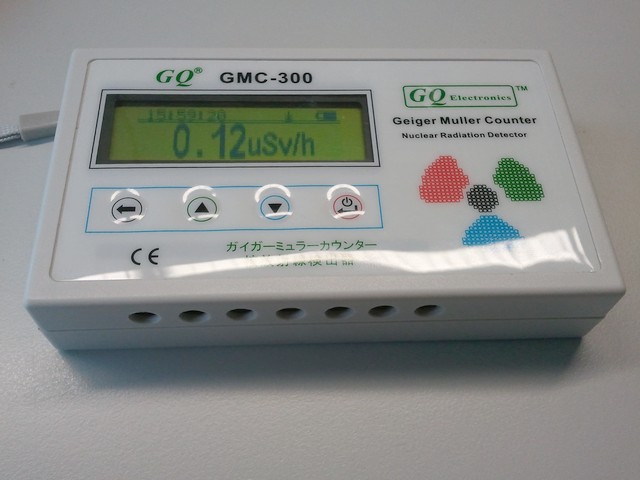

Comparing GMC-300 with my old good Russian dual-tube Sosna I realized that something is wrong with the measured values.
For example, a bunch of 10 uranium marbles give a measurement of around 1.4 uSv in Sosna, and only e.g. 0.30 to 0.40 uSv in GMC-300.
Opening the case of GMC-300, I started getting values of around 2 uSV. Which means that the plastic casing of the device cuts a lot of this type of radiation from entering the tube.
Afterwards I put out one of the 2 SBM-20 tubes from Sosna (leaving it with only 1 tube) and measured on the same sample around 0.7 uSv with Sosna. Then I replaced the SBM-20 in Sosna with the pre-installed M4011 tube of GMC-300 and I got values around 50 uSv. So I decided to replace the GMC-300 tube with SBM-20.
However, the plastic casing problem would still exist.
So I installed SBM-20 a bit higher than normal (I also had to de-solder the negative pin of the tube to save length and use hot glue and extension pins) and made 7 holes across the bottom-up side of the GMC-300 where the tube is close to. Center to center: 1cm, hole size: 6mm.
The result can be seen in the attached photos.
What I got at the end, as expected, is a much higher sensitivity to uranium glass
(GQ: Please consider adding these wholes on the casing of next versions of GMC-300).
