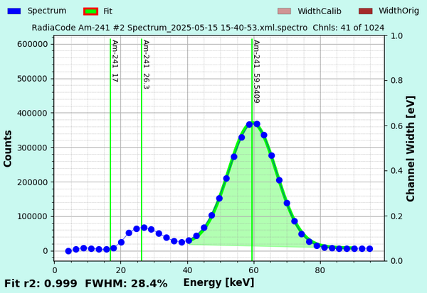

This leaves gamma. The next pic gives proof that it can easily be detected. Recorded with an RadiaCode-102 spectrometer, and analyzed and presented with GeigerLog's new spectrometer feature:
Marked in green is the Gauss-fit to the 59 keV line. To its left is the 26 keV K_alpha X-ray. The 17 keV L_alpha is not visible. Maybe it is below energy detection level of the RadiaCode, but I don't know.

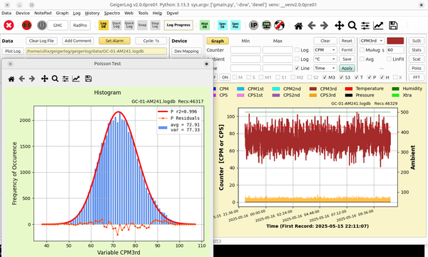

The 59 keV for sure, and perhaps the other two lines as well, will make a glass-Geiger-tube counter click. Next pic shows a recording with a FNIRSI GC-01 counter with RadPro firmware. It has a J321 glass tube (also used in GMC counters).
It gives CPM=73 with a single, intact smoke-detector module sitting close to the tube. The Poisson check confirms a good recording.
